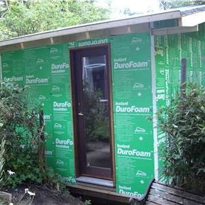

Depending on how much insulation you will be satisfied with, you could add a layer of rigid foam to the underside of the rafters too. Working in your favour is that the size of the shed is so small the heating or cooling loads will be pretty low no matter what you do. When I build my own very similar shed I clad all six faces in 2" EPS and had done with it.
Oh, awesome! I see those boards have radiant barriers as well. Nice shed and thanks for the advice.
