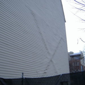

“底物中的警告瑕疵可以通过纤维水泥壁板进行电报”
约翰是对的,我曾经巩固了一个大型框架的项目,指出了PM的墙壁缺陷,被告知并列。壁板前看到的所有缺陷都很好地显示出来。

John B, that looks like a seismic X-brace that the contractor was hoping would be invisible.
