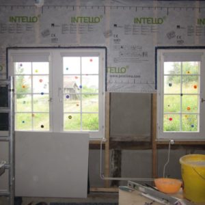

I would first check that the house is managing rain well - has good gutters, lintels, sill that direct water away from the wall. Then check for any spots that get soaked during a rain storm. If the brick stays dry, and is relatively hard/non-absorbing (Probably since there is CMU on the inside, so it is not 125yr old brick). It is probably pretty save to insulate on the inside. Athttp://www.foursevenfive.com,我们喜欢出于各种原因(可持续性,放气,收缩)远离泡沫 - 避免泡沫还可以在需要时使墙壁向内干燥,但确实需要像这样的智能蒸气延迟器Intello我们提供的膜。请看我们Blogpost砖石建筑中内部绝缘的可能性和危险有关更多详细信息,请提示使信封的气密充分利用任何隔热材料(也围绕地板横梁),并让我知道您是否还有其他问题(并且不要忘记隔离屋顶..)
