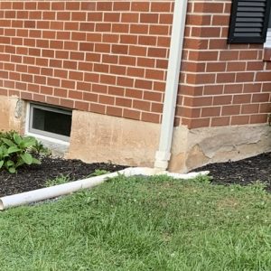

So my joist is not exposed to the exterior it is covered by brick. My basement block has what I believe is a stucco like material over top. Attached a photo to show what I’m talking about. Not sure if this changes anything.
