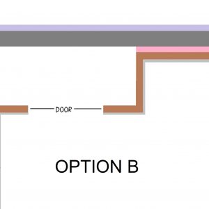

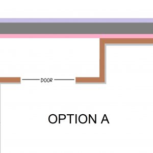

我的计划阶段完成一个基地ment in a home built in 2014 with poured concrete walls. Located in Indiana, near Chicago, climate zone 5. I plan to do most of this with 2″ XPS on the walls, 2×4 framing, then covered in drywall. There are a few places where this won’t always work, such as building closets around the sump pit, water meter, etc. Should the XPS insulation be continuous (this would make sense to prevent condensation on the wall), or should it be excluded in these closets (this makes sense because its not covered in drywall for fire protection)?

So assuming I use XPS or EPS on the inside of my walls, can I use it inside of my sump pump closet (see diagram)? It's not covered directly by drywall, but there is a drywalled closet in front of it.

You can use Thermax or mineral wool wherever you can't cover the foam with drywall. Or skip the interior foam and live with the increased heat loss.
