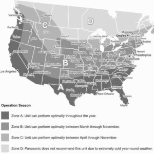

Erik,
The Panasonic ERV is not recommended for cold climates like yours. See the map in this document:
ftp://ftp.panasonic.com/pub/Panasonic/business/building-products/ventilation-systems/pdf/install/FV-04VE1-E.pdf
What you need is a Panasonic exhaust fan.
I've seen some small passive HRVs that could work (passive as in no built-in fan), but it's a very expensive solution when the fan is only running 1 or 2 hours per day. I suspect it would never pay for itself in energy savings. However, it might keep the bathroom warmer and more comfortable.
Martin,
Just curious. I am in zone "B" (East Central Illinois). If I installed this fan as a replacement for the exhaust fans in the bathrooms, could it freeze and refuse to even work as a simple exhaust fan?
I could all Panasonic, but I know all that I would hear is what's mentioned on the map you cited.

The Panasonic ERV will NOT work in a moist environment. (Don't ask me how I know.) As soon as the control board get wet(ish), the safety fuse blows. This is a soldered in fuse, BTW. Also, Panasonic will not warranty the unit if installed in a wet area. (Again, don't ask me how I know.) ;-)
The Panasonic WhisperGreen bath fans with DC motors are very efficient, however.
