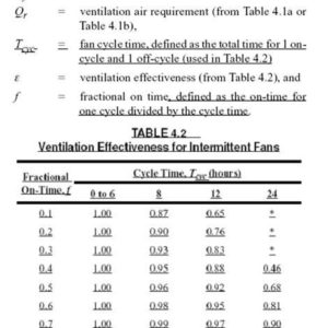

I need an extra 57CFM / 24 hour continuous ventilation in my 1965 New Hampshire (Zone 6A) 1200 sq ft 2-level house, according to my blower door test. The energy auditor recommended the Panasonic Whispergreen. I asked if an HRV (or ERV) would save money & do the job instead, including venting 2 bathrooms which are looking a bit moldy (currently 70CFM each – if no continuous venting were required I’m advised I’d need at least 100CFM). The auditor didnt know the answer.

Since you already have Panasonic exhaust fans, I would leave the short-term timers in place and wire in parallel at least one programmable 24-hr timer, such as the Grasslin KM2 ST, and experiment with various run times. I would also have the existing fans tested for actual flow rate so you'll have a basis for determining run time programming. And move those exhaust ducts so the humid air is not venting into the eaves. It's best, if possible, to vent down at least 3' before exiting the building as this prevents backdrafting and allows condensate to drain outward.

2. in the larger bathroom which probably needed a 100CFM fan in the first place, I could replace the 70CFM fan with a Panasonic Whispergreen 130CFM, program it to run continuously at some low level (40-50CFM) and boost to 130 during showers for 30-60 minutes. Hopefully lowering the general house humidity via this extra venting means I could continue with the existing 70CFM fan in the smaller bathroom but maybe get a new timer to increase venting from 30 minutes to 45 (or 60) during bathroom use.
And what do you think about the idea of running not 50 CFM continuously, but 100 CFM for half the time during the day when incoming air will be warmer? ie not at night.

You could either add a programmable timer to one of the existing fans (or upgrade to a 110 CFM Whisper Ceiling or Whisper Lite for better short-term moisture removal), or replace one with the Whisper Green and operate at low speed 24/7 with the intermittent boost.
Continuous operation provides the best indoor air quality (as well as best moisture protection), and the current ventilation standards require a slight upwards flow rate adjustment for fans that cycle (ASHRAE 62.2 Table 4.2 attached).
我不建议关闭风扇在近了t, since that's when you most need fresh air - when you are in the house for long periods and your body is is recovering from the diurnal stresses. And that's also why the most important place to install a make-up air inlet is in the bedrooms.
