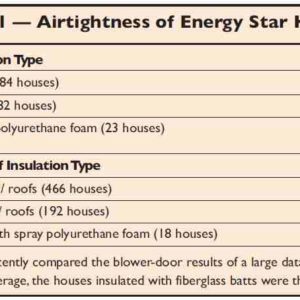

There have been several field studies, however, looking into fiberglass insulation performance. These studies don't answer your question -- but one of them, a 2005 study by Bruce Harley, showed that fiberglass-insulated homes have higher rates of air leakage than homes insulated with cellulose or spray foam.
I reported on Bruce Harley'ss findings in the April 2005 issue ofEnergy Design Update, in an article titled "Fiberglass-Insulated Homes Are the Leakiest." Here are some excepts from the article:
"Recently Bruce Harley, the technical director for residential energy services for the Conservation Services Group in Westborough, Massachusetts, was able to study correlations between airtightness and insulation type in a much larger number of buildings. Harley assembled airtightness data on Energy Star homes (including single-family and multifamily homes) completed in 2004 in Massachusetts and Rhode Island. All of the homes were blower-door tested after completion.
“房子的数量数据集depe不同nding on whether the houses are divided by wall insulation type or ceiling insulation type. (There are several reasons for this, including the fact that a small number of houses, including homes with SIP walls or roofs, use a variety of insulation types or unusual insulation types. There was no easy way to segregate the houses with more than one type of insulation from those with a single insulation type.) Harley was able to look at airtightness data for 906 homes divided by wall insulation type, and 702 homes divided by ceiling insulation type.
"Harley found that houses with walls insulated with spray polyurethane foam were significantly tighter than those houses with walls insulated with cellulose, and that houses with walls insulated with cellulose were significantly tighter than those insulated with fiberglass (see Table 1). Sorting the houses by ceiling insulation type yielded similar results to those obtained by sorting the houses by wall insulation type.
"Although the data clearly show a consistent correlation between insulation type and airtightness, the reasons for the correlation are unknown."
[Click on the image below to enlarge it.]
