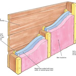

I had the same though as Akos. If you proceed as if the house had no sheathing and create an air gap, you give the masonry somewhere to dry when the sun is beating on it. Basically, you'd be creating the air space it should have had from the beginning. Something like this:
I can’t furr out the studs here due to the way the interior bend and trim are constructed, but I can use some 1/4” fanfold HPS with the “safe and sound” mineral wool that is about 3” to give an air gap of about 1/2”. The thin XPS would still be vapor open(ish) for some drying. There is nowhere to tie the vent gap into otherwise unless I get really creative with drilling some vent holes in the window sill. I don’t have a way to vent the bottom to the outside at all.
最初,我一直在考虑只使用定期的深度矿物质羊毛巴特和内部的膜,思考是可以干燥的,但这将是直接与旧护套的矿物质羊毛棒。您是否认为像布莱恩(Brian)的绘画中有一些刚性泡沫的气隙是一个更好的主意?该方法的缺点是R的总体值较小,并且没有真正发泄该空间空间的实际方法。我可以无论哪种方式都可以构建它,只是试图以最佳方式进行 - 最佳创可贴,基本上是:-)
