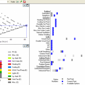

I attached a BEopt graph the best options are close to the bottom.
When you look at the output I posted each dot is a variation on a model of a house. The dots on the line drawn on the graph are all optimal models in some way. The one on the left side of the line have lower capital cost and higher energy usage costs. The ones on the right side of the line have higher capital cost and lower energy usage costs. The ones closest to the bottom are the modes with the best return on investment given you inputs.
