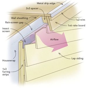

    1. Would horizontal furring strips, with adequate kerfs for airflow, be okay... or should I go to the trouble of a base-layer of vertical furring and overlay rows of horizontal over that? Basically will horizontal furring strips only defeat the purpose of the rainscreen?
    2. If we went with the 4" of exterior foam, w/rainscreen, I am having trouble visualizing trim details at the top of the wall where it meets the soffit. Would I trim that with an extra thick trim board and run the foam up to that.... or run the foam all the way to the top of the sheathing and put trim board over top of it as well as the siding? Would this area require flashing? How would I create ventilation for the top of the rainscreen..... Any suggestions or visuals would be great.

    除非你谈论的墙是特别暴露于天气(由于刺痛的屋顶悬垂或不寻常的高度),或者除非房子在一个非常暴露的位置(俯瞰海洋的山丘),否则除非房子(俯瞰海洋),否则我认为你不需要两个毛茸茸条纹(垂直+水平)。水平毛刺条将为您提供Rainscreen间隙的大多数好处,并且在雨后,壁板应该易于干燥。
    The trim at the top of your wall (the frieze board) can be in the same plane as your battens. Or, if you prefer, you can use 5/4 stock for your frieze (installed on top of the siding boards) and 3/4" (nominal 1") battens, so that the frieze is proud of the battens.
    有关排出RIANSCREEN顶部的信息,请参阅以前链接的文章:All About Rainscreens。但请记住,如果您只需安装水平粗发条(而不是垂直+水平),就没有真正需要排出雨屏差距的顶部。
