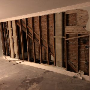

My wife & I have begun restoration of a Victorian, pre 1911, three story in Syracuse, NY. She is documenting the project on YouTube as “The Grand Lady – Syracuse”.
We suffered a roofing company failure several months ago which resulted in the loss of one side of every original interior lath-plaster cavity and of all lath-plaster on the exterior walls. This due to complete saturation of the house interior, top to bottom in a heavy rain event with most of the roof removed and inadequate temporary protection.
We had, prior to the house soaking roofing event, begun removal of all the exterior side in preparation for application of 1” exterior rigid foam board, seam taped then over-wrapped and seam taped with Tyvek Commercial wrap. 1×4” furring follows on the exterior up each stud line. Planned siding to be lap siding as rain screen, maintaining the plenum space for convection.
With the interior side of the exterior walls now opened to the 1” sheathing, we have opportunity to choose a better exterior insulation than the loose fiberglass which was water soaked in the roofing company failure. I had thought to use spray foam after the electrical and rough plumbing is completed. Tonight’s reading however, brought me to spray applied cellulose as another possibility, with perhaps some additional benefit. Of this however, I am not certain.
May I have some of your thoughts about the insulation choices to be made here? Our concerns are first longevity, safety, insulation value, air seal and noise control as two side face streets which are occasionally loud.

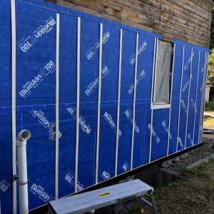

Cedar claps over 1/4" air gap over self adhered WRB over the old sheathing. Blueskin providing the water and air barrier with a vapor perm of 33(?). Air gap to promote drying to exterior / extend the life of the paint on the claps. Doing it again ... I'd use Hardie plank instead of the cedar.

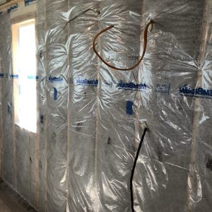

Inside 2x4 and 2x6 exterior walls all are dense packed mineral wool with Membrain vapor retarder. Would have liked a thermal break somehow.
I was impressed re: how much wetting / drying we observed when we opened up the exterior walls, so we took care to provide robust water and air barrier with drying path to exterior.

I'd put some flashing tape around the wires where they penetrate the Membrain material. The flashing tape will help to reinforce the Membraine to prevent tearing.
Bill
Yes, we did that just before the blueboard went up.
