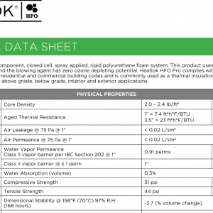

I attached the product sheet.

According to the data sheet the aged thermal resistance per inch is 7.4ft^2hF/BTU. Is that the same as R-value?
Yes. I'm not sure if the others are referring to the fact that the R-value/inch listed is higher for the first inch (7.4) than for additional inches (i.e. R-value at 3.5" is 23 which means that the additional 2.5" is at R6/in). The only explanation I can dream up for that is that the insulating value is actually better at large temperature differentials than at small, but I really don't know why that is.

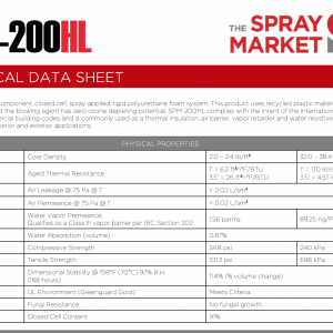

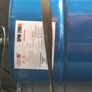

The contractor showed up to spray Friday and I went to his truck to see the type of foam he was using. Sure enough, it wasn't the Demelic Heatlok Pro HFO he said he would spray. Instead it was Spray Market SPM-200HL. He insisted it was the essentially the same stuff, just that his supplier ran out of Demelic Heatlok. I look up the aged thermal resistance of the SPM-200HL and it was 6.3 R-val at 1" and 26 R-val @ 3.5" . So less R-value at 1" but somehow greater R-val at 3.5"????

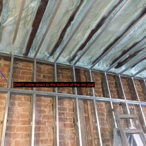

We agree to have his crew come back Monday to finish. I point out some areas near the rim joist that he didn't come down low enough on and after some discussion he agreed to spray those as well. I have not paid them yet.
I'm upset that the contractor bait and switched the product on me. At 1" the SPM-200HL has 85% of the R-value than Demelic Heatlok Pro. Will the contractor accept 85% of the agreed upon contract amount? I'm going to call the local distributor to find out the price difference. If it's significant, I'm going to ask for a discounted contract. Or request they spray foam on the walls where the bedrooms are located for some moderate soundproofing. The building is attached on both sides.

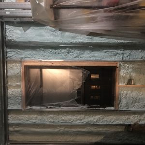

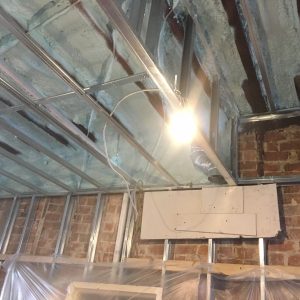

Anyway - here are some pics from the job and the SPM-200HL data sheet.
Every other manufacturer I've seen specifies a lower R value for short term aged at 1" - because the gases leak out quicker when it's thinner. No idea why Demelic would see the opposite behavior (higher R value when thinner). But note that none of the numbers are accurate anyway (you want a lower "very long term aged R" which you won't get from the manufacturers).
不一样,完全不是。b你引用一个泡沫lown with HFOs, which has a global warming potential of ~1. Instead they used a product with blown with HFCs with a GWP of 1000. At the very least, please don't have them spray more of it, especially on interior walls just for soundproofing.

Regarding the higher R-/inch at greater thicknesses- the reasons are complicated, but that is not a rare phenomenon for closed cell foam insulation.
