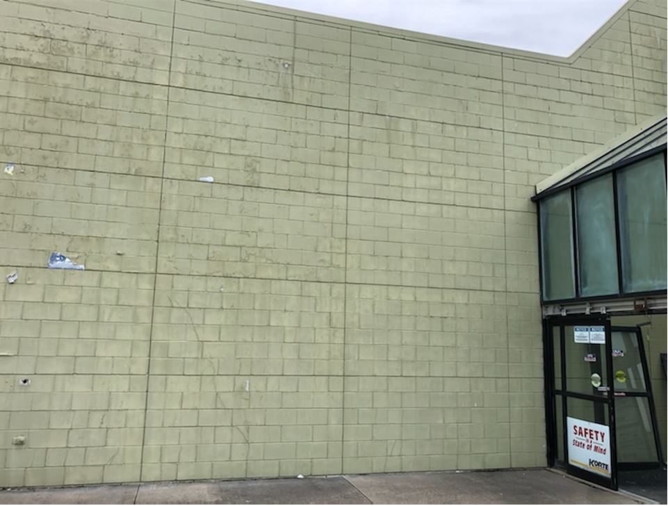

有30年历史,28000平方英尺的密歇根建筑。气候区6 b。12英寸的结算系统。湿的基础。我们已经尽力补救了。我们完全可以肯定方块中的泡沫将水吸进了CMU。相当数量的冻融开裂到第5块赛道。不仅仅是砂浆接缝开裂,而是真正的块体开裂。此外,CMU的弹性涂料也很难保持,因为夏天从外部测量的水分含量超过15%。
很多的想法。有人有经验吗?
挖出一系列的破洞?
在底部轨道附近加装某种类型的灯芯?
完全去掉一些块,换上空心块?
拆下一些积木的外表面,取出泡沫,盖上通风口?

    你们真是帮了大忙。我是业主,有一些建筑知识。让一个全国性的承包商在现场,为亚马逊建造它。还有一个舍温·威廉姆斯技术代表,一个结构工程师,和一个伟大的泥瓦匠。几个根源。很多的想法。我们都同意,在可能的情况下,我们必须努力改善排水系统。粘土使水似乎栖息得很高,慢慢地消失了。7年前的上一次油漆工作做得很糟糕;没有滚回,所以销孔让水从弹性涂料下。 See photos. Will tuck point bad motor joints, remove broken 12" block that are mostly on the section of the building that was unheated for 8 years. Agree we must break capillary action in the foam near ground level. Debate on how to do that well but cost effectively. Is just cutting the mortor joint and through the foam to the inside of the block enough? That would provide a 1/2 inch gap. Need to slip anything in the gap we crated like a wicking material we found online, or pieces of sheet metal or plexiglass? Or some sort of grout or caulk in the cavity? Mortar it shut or leave a small mortar joint weep hole every second, third or fourth block? Again, thanks so much.

    1. michaelrooney||# 7
      刚发布的照片。

    谢谢,Walta。是的,杰夫·贝佐斯喜欢租房。I would like to sell but here I am. JPG photos should show up now. We're going to install a capillary break, just deciding how. Open to suggestions. Maybe we grind out 10 lineal feet, skip a few feet for wall strength, then grind out 10 more. Dig out some foam, then Insert metal pieces just between the webs? Or grind through the block webs to the inside face and lay long metal strips? Either way, there is an idea of cutting in a lateral weep hole every 5th block or so. Prefer continuous metal or plastic capillary breaks but not sure how to get them in safely. Afraid to cut through all of the interior block webs. The notion of some sort of caulk was in reference to sealing the capillary breaks at joints... You can see that we are wrestling with affordable technique. None of us has done this on retrofit.
