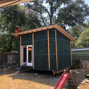

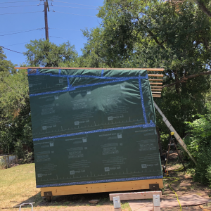

Pretty much thehttps://foursevenfive.com/2x-framing/"smart enclosure" with rainscreen gap but no external insulation. 2x lumber, shed roof with no eaves, taped membrane (zero perm proclima green stuff) all six sides, with high perm membrane over the sheathing cut for the vapor ridge port. Rainscreen using 1x4s and wood siding, metal roof over 2x4 criss-crossed on the flat (creating 18" overhangs) with Cor-a-vent.

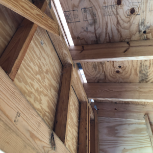

Floor was indeed the hardest bit. I laid a 2' wide strip of membrane on top of the beams, then the joists went over that (cantilevered). I installed rockwool batts before adding the taped membrane. I then taped the floor sheathing above that so that rain didn't get in there during the rest of construction. But I left the underside membrane off until the roof was on, just in case. The bottom of the floor joists were high enough that I could crawl under, staple the membrane under the joists and tape to the flaps that I had put on the beams later. The joist to beam connections were toe-nailed with a few hurricane clips (which were obviously a pain to tape as they came through the membrane).
If I did it again I'd use Zip sheathing (much more widely available now) rather than the membranes and I'd look very hard at the approach of using hand crank equipment lifts to raise the floor up for air-sealing the underside. I think this is the article:https://www.finehomebuilding.com/project-guides/insulation/air-sealed-and-on-piers

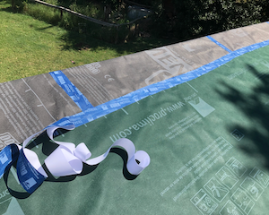

Actually I also did a shed roof, just put the sheathing cut at the high side, with high perm wrap over the gap (about 12" of high perm taped onto my low perm membrane). The gap in the sheathing is only 2" so I can't see that it affects racking strength with the rest of the roof entirely sheathed.
I then ventilated above the membranes with criss-crossed 2x4 on the flat creating 18" eaves (and metal roofing above that).

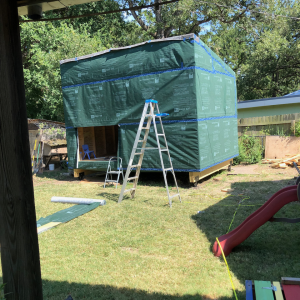

Hey, I found some pics, one from above, one from below (inside). And a few of the rest of the build.
Oh, and don't put it up so high because then you have to also build a deck and a ramp to get things in and out. Ask me how I know :) So that's why if I were ever to do this again I'd just beams in the floor (not cantilevered) and air-seal the floor from below up on equipment lifts, then lower it back down, as shown here:https://www.finehomebuilding.com/project-guides/insulation/air-sealed-and-on-piers

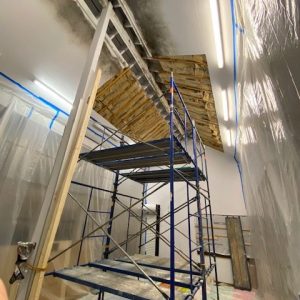

This solution interests me greatly- I have a garage/workspace that was built out before I became homeowner. It is an insulated / sheetrocked space with a cathedral ceiling. For some reason the builders left about 24" to either side of the ridge beam open and un-insulated. There is R-38 fiberglass batting the rest of the way down. Outside there are soffit vents but they did not use vent baffles in the cavities- so no airflow! The space is heated /cooled with a heat pump. Needless to say the ridge interior became a moldy mess. I have addressed the mold issue but now am at a loss as to how to fix this without tearing out all the sheetrock and insulation in the roof and venting it properly with a ridge vent and baffles etc. This vapor port solution looks like the ideal fix- I could repack the insulation I removed, resheet rock the area I removed that was damaged, close the soffit vents and construct a vapor port at the ridge. I'm in CZ3. Does that make sense? It seems like a good solution. There is a catch. The roof is done with open sheathing- 1x8 boards with maybe 1/2" gaps - would the vapor port method still work? I'm not looking for perfection- It's a shop/ studio space I keep as minimally heated cooled as I can.
