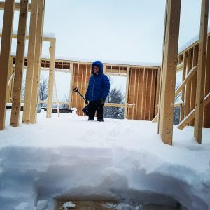

Also, if you live in snow country like me, get the roof on as fast as possible! (See attached)
