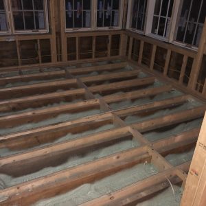

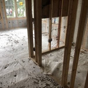

Here's what I did for my bonus room. The sub-floor was up. We sprayed in 3" of closed cell foam essentially creating an air sealed bowl into which we dense packed mineral wool, then laid down the Advantech subfloor. Some thermal bridging still going on, but pretty toasty.
