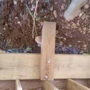

Howdy. I was visiting a man’s getaway cabin and when I looked at his cantilevered deck, I heard in the back of my mind: “Danger Will Robinson!”
为清楚起见包括图像。
危险:
1. 4ft Cantilever with 2×8.
2. Only two of the 6 structural 4×6 posts in ground.
Situation:
1.甲板脱离了陡峭的路堤,悬挂在水面上约9英尺。
2.它有8ea 4×6个柱,其中只有6个阻挡梁,其他两个恰好连接到外部托梁上。

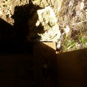

3. Off the 8 posts only 2 are in the ground and these are immersed in permanently soaked soil as they are just a couple feet from lake and the 4″ side of post is taking all the lateral for the entire deck, aside from friction that the walkway onto deck and other posts provide (next to nothing).
4. The other 6 posts are setting on top of the ground on different items (soil, rock, or block with no attachments.
5.甲板是16英尺X16英尺,在2-2×12梁的顶部的中心,位于2×12梁12英尺的顶部,并由三个帖子8ft o.c。
6.甲板有一个4英尺的悬臂。
7.?外侧2×8托梁在它们下方立即有2×12,因此它们在外部托梁外保持2×20。悬臂末端的2×8个标题托梁在其下方具有另外2×8,其实质上是2×16。

  1. Mikeysp.||#1
    这里有两个添加清晰度的照片。不能为我的生活了解照片如何在手机上右侧,笔记本电脑上,但上传时没有?对不起。

    Zephyr7||#4
    I've had problems with pics getting flipped when I post too. I don't know why that happens -- it seems to be random.
    你不应该让螺栓拿起像所示一样。托梁应静止在柱的顶部,或者在切入柱中的凹口中,使得螺栓刚刚将组件保持在一起,但实际上没有携带任何负载。如果您实际上需要螺栓拿起负载,你必须担心木材中的剪切应力,并使用分级硬件(不是通常的“2级”硬件商店的东西),因此它变得更加复杂。
    I'd have a structural engineer review this and come up with a fix. My guess is there will be a number of changes you'll need to make.
