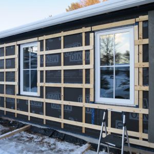

I did something somewhat similar to Eric with the double layer of rainscreen strapping. Effective but probably not the simplest solution in the way I integrate the windows.

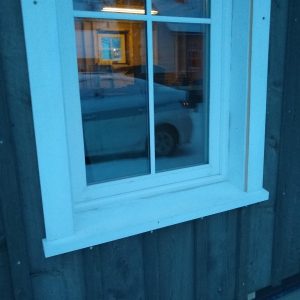

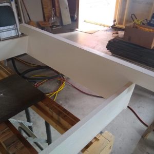

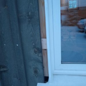

This is a double stud wall with 'in-betweenie' windows. I ended up pre-making trim bucks out of Boral with a pseudo traditional sill appearance. A bit of work to be sure. The trim gets screwed into the 1x4 strapping from the side and caulks to the window. Not all needed flashing is shown in the images, and the final trim (painted pine) isn't actually installed in the last pic, but gives an idea.
