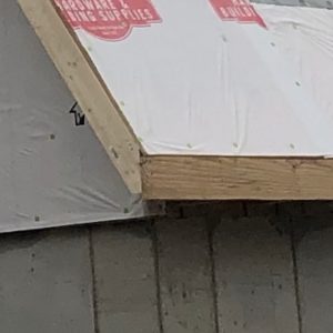

This is what the eve and rake look like

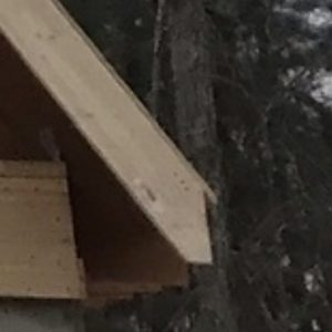

Here’s another angle
You need some kind of drip edge.
From your photo I see two kinds of house wrap installed by lapping them vertically on the roof. Neither appear to be installed correctly or are appropriate for roofing. Your pictures are low quality, however. Is that temporary?
If you do things in backwards order in construction, final results may reveal lower quality workmanship. Although, like others said it can be done.
In my experience, when we did things backwards in residential construction, due to the GC being a sloppy project manager, final results tend to reveal less than ideal workmanship and clients take notice. Beware.
Yes it’s temporary, they ran out of the roof paper
