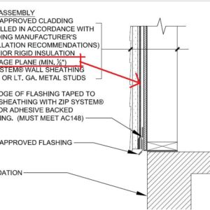

我正在研究位于威斯康星州的一个加法项目。我的计划是使用Huber Engineering拉链墙护套。
In reviewing Zip walls installation instructions, I noticed that Zip calls for a minimum eighth of an inch drainage plane between the rigid foam and the sheathing. In my wall section I planned to include a drainage plain (rain screen) on the outside of the 3 inches of rigid foam.
Will the recommended Zip wall drainage plane reduce the effectiveness of my foam insulation?
This is not a typical detail in conventional wall sections using traditional OSB sheathing. Let me know if anyone has any tips. Thanks

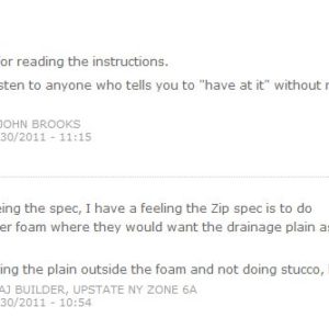

    Kudos to you for reading the instructions.
    Please don't listen to anyone who tells you to "have at it" without reading the instructions.

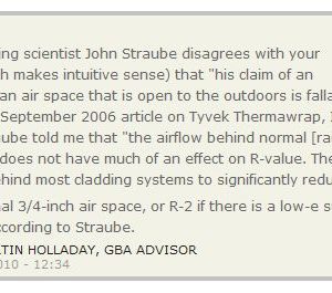

    this comment from John Straube .......
    似乎与您的问题有关

    约翰,谈到细节,您发布的细节永远不会由我构建。当用泡沫外出时,可以详细介绍所有六个侧面。邮政编码不得对基础细节进行邮政编码。
    如果您想真正帮助约翰,请绘制该细节完成。

    Huber拉链屋顶和墙壁护套结合了一个产品中的结构面板和耐候性屏障(WRB)。如果您打算将拉链护套作为WRB,您应该使用(我认为如果不这样做,Huber将无效保修)提供排水平面(允许排水的空间)在护套和外部泡沫之间。这样做将降低护套和泡沫之间的静水压力。约翰·布鲁克斯(John Brooks)指出的BSC文章在解释这一点上做得很好。
    There are a few housewraps that will provide the 1/8-inch gap: Tyvek Drainwrap, Weather Trek dimpled housewrap, and Greengaurd Raindrop housewrap. However, using these products make the WRB system of the Zip panels pointless. If I were building the home, I would get rid of the ZIPs and use OSB (plywood would be better) sheathing with taped joints to achieve the air barrier, and one of the above listed housewraps as my WRB.
    对于您的问题,您的差距降低了泡沫护套的有效性 - 乔博士在同一“思维差距”文章中解释了这一点:约翰提到:
    "But won’t the tiny gap cause a loss of thermal performance of the foam sheathing? Yes. How much? About 5 percent of the thermal performance of the foam sheathing (not the entire wall assembly) with the 1/8-inch gap, less with a smaller gap. With “crinkly” stuff (draining housewraps) you loose next to nothing. Is it worth it? Yes, in my opinion, the loss in thermal performance is trivial compared to the reduced risk and improved durability."

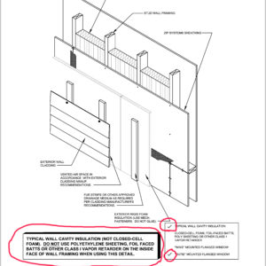

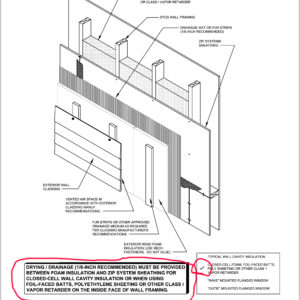

    他们还需要对任何腔腔的缝隙中的缝隙,在腔体中具有闭合泡沫绝缘材料和外部刚性泡沫,因为邮政编码的任何方向都没有任何方向的干燥能力:
    http://www.huberwood.com/assets/user/library/K-12-FoamWithGapISO_JPEG.jpg

    If you look closely you will find Huber provides 2 very different drawing one for walls with interior vapor retarder (barrier) with the drainage channel (vent).
    Any wall with 2 vapor barriers is a recipe rot and water damage.
    请查看我突出显示的两张照片。

    The Zip System advice is consistent with everything we've always said here at GBA: If you install rigid foam on the exterior side of the sheathing, you don't want an interior vapor barrier.
    The crinkly wrap is necessary if someone specifies closed-cell spray foam between the studs. But it's much better to avoid the problem in the first place by specifying cellulose or mineral wool between the studs.
