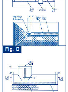

Generally I see the vent stopping before the vent gets to the end of the roof.
As shown in this image from GAFs instruction.
Do you know who made your vent?
Walta
https://www.buildsite.com/pdf/gaf2/Cobra-Rigid-Vent-3-Installation-Instructions-B24908.pdf
