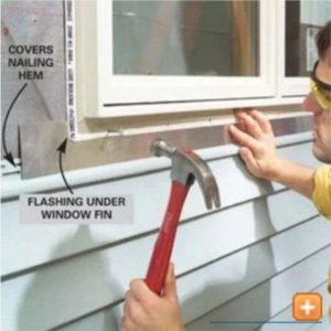

On vinyl I’d place wide flashing tape or aluminum flashing under the bottom of the J-Channel and over the first full course of vinyl underneath. Because of how everlast interlocks, I can’t figure how you’d do the same.

I guess that's my concern. If it's pocketed and you can't flash between the bottom pocket in the next course of siding all the water goes behind the siding from the bottom j channels. Pic attached (found on another site) showing how I do vinyl to avoid this. I can't figure how you do this with Everlast though.
I can’t say I’ve used that detail before. If using vinyl (back ventilated siding), I have not worried about getting residual (not bulk) water behind the siding as long as the Wrb is properly installed.

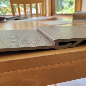

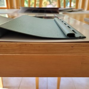

Fair enough. That's probably 99 of 100 installs too. With the Everlast it doesn't have vents or and edge that pulls water off the wall. So it looks like it wouldn't dry out like vinyl. Maybe vinyl is best for me... I just like the looks of everlast.

Vinyl vs Everlast pic.
