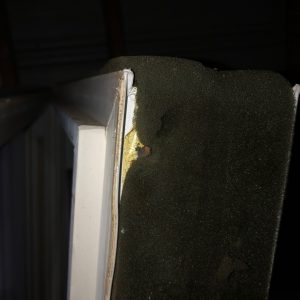

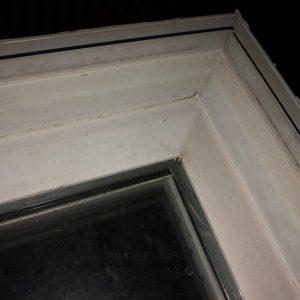

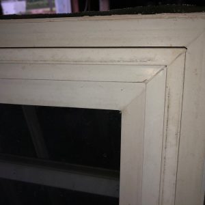

Can you take a picture of the outside? Most have grooves for metal trim.
Akos, here are pics:
Can you treat them like a flangeless (European style) window install? Flash the rough opening -- sloped sill pan with a back dam (either bent metal, or built up with wood and then covered with a membrane or fluid-applied flashing product), tape the face of the window to the WRB, and then cover the tape with window trim. Someone in a similar position here://m.etiketa4.com/question/an-unusual-issue-3-pane-replacement-windows-with-no-frames
Looks like the windows still have a bit of a flange on the outside. I would treat this similar to a flanged window, connect your WRB to this flange, install head and pan flashing and trim as per the link bellow. This way if the windows every need to be replaced, you can simply install standard flanged windows.
https://www.protradecraft.com/detail/sill-head-and-jamb-details-new-windows-old-holes
Notice that the sill exits bellow the bottom trim and the head flashing is above the top trim.
