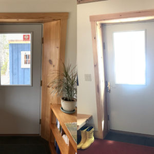

You can put exterior doors in the outer wall of a double stud wall and have them open to the interior. You can make the inner wall opening wider so the door has room to swing open. You just have to figure out a desired trim extension situation.
It may not be able to swing completely 180 degrees, but that wasn't a problem in our situation because of walls near the doors. I'll attach a photo from our build that may give an idea.
Maybe not your desired solution, but may be easier than dealing with the threshold issue.
Current photos from inside.
