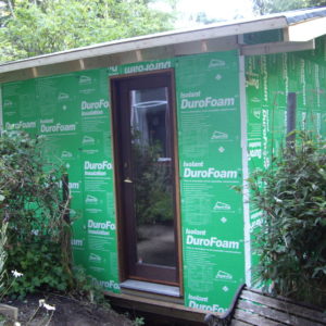

除了Panabode日志的墙壁,you are describing the she-shed I built for my wife this fall. The floor is a layer of 1/2" plywood with 2" EPS then of layer of 3/4" t&g plywood. The walls are insulted with 2" of exterior EPS and the roof is a sandwich similar to the floor.
Both the plywood and the rigid insulation were taped, making the structure quite air-tight. The disadvantage of the Panabode logs is they leak air and there is no good way to seal them. Then again with a building that size, who cares?
Being full of books, we keep the shed minimally heated with a portable oil heater in the winter, but even without heat I doubt you will have any moisture problems at all. The small amount of moisture you will generate while using it can be dissipated by opening the door or cracking a window. My similar uninsulated tool shed only shows a bit of discolouration on the ceiling plywood because the roof is uninsulated.
Thats a long way of saying I think your plan will work fine.
The she-shed before taping the insulation:
Once the weather improves and I get the rain-screen and siding on, I'm going to built an arbour in front of the door and hopefully in time the Clematis will cover it

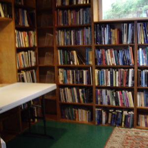

Just for fun, here is the inside:

Nice! Maybe I'll have to start building sheds to solve my "too many books" problem. Every now and then, I'll just build another shed.

Getting 2000 odd books out of the house has been great, but the project has been a mixed blessing. My wife has found some of her friends now have shed-envy. Relationships have become strained.
