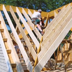

3. You can't vent a cross-gable roof (see image below), because the valleys interfere with soffit-to-ridge venting. You will need to come up with an unvented approach rather than a vented approach.
