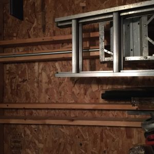

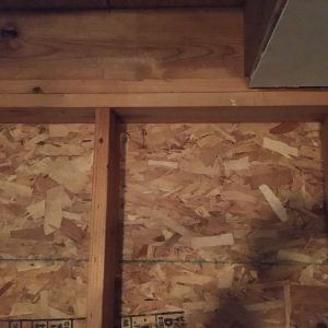

  7. Eric Cyr||#8
    Brian
    I've attached more drawings from our home plans and a few pictures to show the added vertical studs on the first floor and the double top plate.
    谢谢大家的回复。
    我倾向于将它们拆除,以便为岩盘绝缘提供更多空间。
    File format File format File format
    1. GBA Editor
      Brian Pontolilo||#9
      嗨,埃里克。
      Was there an architect or engineer involved? If so, I'd double check with them before removing the extra studs, however, I still can't see why they are necessary. And as others have pointed out, if you keep them, toenail them to the bottom plate and add some blocking.
