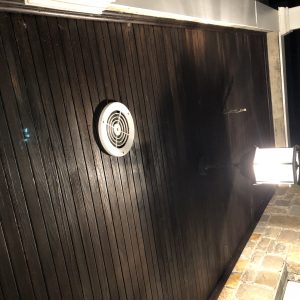

Can I reuse the existing flush box as is? Or move it to a surface mount?
Light currently mounts to electrical box no pole. Guess I’m trying to figure out what I should do before they install...
Pic
They make “extension rings” for electrical boxes. Extension rings are like a box with no back. You mount the extension ring to the original box, and the extension ring serves to bring the edges of the box up the new finished surface level. There are also “mud rings”, which are usually used with drywall, but serve basically the same function. Which way you extend the box depends on exactly how you’re doing the installation and the type of existing box you have.
If your light is heavy, try to mount the nipple (the threaded tube the fixture wires go through) to the original box for maximum strength. If this is not possible, I like loop a piece of steel wire through a hole in the original box and the mounting flange for the nipple. The steel “safety wire” is just a little extra insurance against a heavy light coming loose and falling.
Bill
