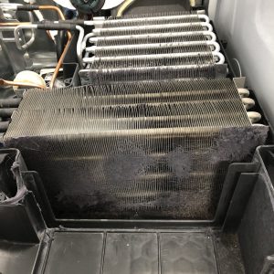

我的问题是有两个线头过滤器screens that I can clean every time on top of vacuuming it out often. After the second lint screen there are two metal mesh screens and the second one has begun to build up lint. Does anyone know a way to remove these to clean them. Whirlpool and the tech who cane out was no help. I may have to cut the screens out and make removable ones that can be cleaned.

    这是一个普遍的投诉。到目前为止,我没有看到好的解决方案。我已经考虑过您的建议;但是请注意,只有一个金属屏幕。累积棉绒的背后的东西是热交换器(如果是蒸发器或冷凝器,我的头顶不记得我的头顶)。
    我尝试做的是在“杂交保健”过滤器和金属屏幕之间安装更好的密封。这似乎没有太大的不同。我还尝试将几层奶酪布放在那个金属屏幕上。这效果很好,但是呆在原地是屁股的真正痛苦。

      感谢您的反馈意见。我的确实有两个金属网屏。如果您在迄今为止,您也许可以看到它。也许它是一个略有不同的模型还是更新?第二个直接在热交换器的前面。如果我想出解决方案,我将发布它。现在,我可能只是在屏幕侧面戳一个孔,足以在其中放一个小真空喷嘴。

        I can't see it in the picture, but I guess it's a revision. My model is a slightly different number. It's sad that they revised the design, but failed to fix the crux of the problem. Let us know if your vacuuming is successful.

    It was a little over a year after using the dryer before I noticed some build-up on the fins of the coil behind the last filter screen. After spraying a little water on the lint, I straightened out a paper clip, pushing it through the screen to reach the lint on the fins, gently pulling on the lint to get it to fall off. With the lint being wet, it was easier to get larger chunks to fall off at once. Definitely time consuming and delicate work to avoid damaging the fins.

    沃尔塔, if i blow it inward it will be going directly i to the heat exchanger, exactly where you don't want it. My picture doesn't really show the setup that well, i wish it was that easy. I think you nailed it tho, maybe yearly or every other the unit is going to have to be Dissembled and cleaned. Sucks for me the stacked in a closet in a drain pan. And those dryers are heavy! Its just a shame the normal consumer is not going to be able to do this and there dry times will keep increasing until its useless.

    When I look at that screen it seems any lint is on the back of the screen and being pushed toward the screen with the coil in the background, it is hard to tell from the photo. It seem they choose to filter the air coming out of the coil with an unclean able screen in front of the filter, does not seem like a good plan to me.
    I say the lint on the screen is in a bad place for air flow if you move it around, it will be blown back toward the same screen this time it may get thru the screen and get caught in the filter.

    In the drum is a regular style lint filter, the air flows down and to the right from there where it goes through the second cleanable lint filter. After the second filter it goes through two screens towards the coil. Looking at the picture the air/lint goes forward into the coil not the filter.

    不知道这是否有帮助。但是昨天,我注意到在“ Eco”模式(又名,没有电线)上干燥时,鼓根本没有变热。因此,我完全拆开了干衣机。我注意到覆盖所有东西的字面覆盖物。尽我所能。
    其他人提出的主要问题之一是二级过滤器(机器底部的右下角)是一个永久的金属网格滤波器,可导致蒸发器线圈和鳍。可以删除此过滤器。但是,这几乎需要完全拆卸。我将发布一个指向显示此过程的视频的链接。以及指令小册子。在这些说明之后,您可以提起该网格过滤器,以访问蒸发器线圈并清除。这是一个主要的设计故障,需要完全拆卸才能清洁线圈。

    As for the lint build up behind the permanent filter, this is a problem. The owners manual does warn "Lint should be removed every 2 years, or more often, depending on dryer usage. Cleaning should be done by a qualified appliance servicer." So far I have not found a tech who understands or is willing to do this, but I may keep looking. Maybe in a few months or so I will become confident enough to follow the video posted in this thread and do it myself; thank you for a video that finally focuses on this model!
    同时,我通过使用多个小齿的金属叉使用沙龙梳子来散布棉绒,而没有损坏屏幕。然而,然后将松散的皮棉通过屏幕分解和真空很慢,因此仍在寻找一种更好的方法。

    After exploring the links in this thread and downloading HybridCare Job Aid W10764068A I gained the confidence to perform a thorough internal cleaning and removal of the build-up from the heat exchanger. The Job Aid contains excellent comprehensive instructions with videos. The section on Removing the Reed Lint Switch outlines which previous steps in the same Job Aid you will need to follow. It took me about 3 hours to carefully remove everything and another 3 to clean and put it all back together. I could probably do it again in half the time.
    笔记that model WHD560CHW is a little newer than the model WED99HEDW0 in the Job Aid. As far as I could tell the only internal difference was the location of the CCU (eliminating one component that needed to be removed).
