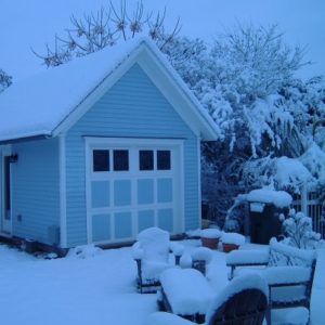

My Garden Shed/Shop is 12 x 20 ... slab foundation...the roof is light colored comp. shingles
The shed is unfinished on the inside... no venting or insulation.
I store cardboard boxes and tools and "stuff" ... no rust, no moist cardboard...no problems
Heck, I even store drywall mud !
the Overhead door faces south
The photo was taken after an extremely rare snow
