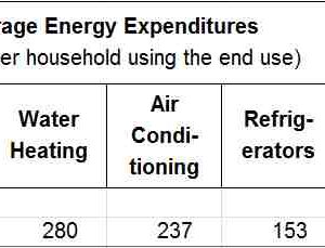

Your reported savings are statistically impossible. In 2009, the average U.S. household spent $593 for space heating and $227 for air conditioning -- a total of $820 for space conditioning. (Source:
http://www.eia.gov/consumption/residential/data/2009/index.cfm?view=consumption#end-use)
Needless to say, you're not going to get $600 to $850 of annual savings from duct sealing, if your total costs for space conditioning are only $820.

The same folks would probably get a better ROI out of ductless air source heat pumps though. Assuming a typical ~15% duct losses, for correcting that to add up to $600 savings implies an annual space conditioning cost of $600/0.015= $4000.
Such houses exist, but they're not the average. That's more than the total non-transportation energy costs for an average home in Massachusetts, according to EIA data:
http://www.eia.gov/consumption/residential/reports/2009/state_briefs/pdf/ma.pdf
Of the ~$3600 in total household energy costs in MA only about 60% of that is for space conditioning (almost all of which is heating), so the total space-conditioning costs are about 0.60 x $3600= $2160. A savings of $600 there by duct sealing would imply 28% of the heat load is related to leaking ducts. An $850 savings would imply fully 39% of the heat load is related to leaking ducts.
While that type of leakage isn't unheard of those probably the 2-sigma outliers, not the median or "...on average..." savings to expect from duct sealing in anything but high fuel-cost situations.
