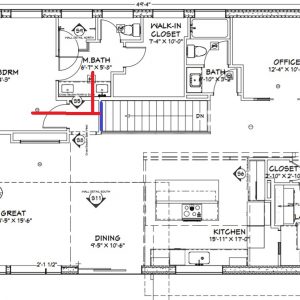

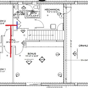

So how does one do that with a ducted mini system? I attached couple pics of floor plan. Blue line would be a location that I could do a ducted mini(red being duct runs), but I have zero idea how far the ducts can be etc. The great room is 10', master is 9', so that little hallway between the master and great room could have a drop ceiling in it to hide the unit. Same goes for downstairs above the closet. If I lose some height in closet, not a huge deal.

You keep the ducts inside the envelope exactly as you suggest. A drop celing bellow the actual ceiling for the unit and some bulkheads around the ducts that you can't run inside an interior wall/floor.
Well insulated and sealed basements in my much colder climate need very little heating and not much cooling, there is no need for a dedicated unit just for the basement. You can heat/cool your entire house with a single ducted unit.
The basement is generally the best spot to install the HVAC with ducts feeding the upper floor. The best spot to put the unit is near one of the outside walls, run a large trunk in a bulkhead either at the bottom or top of the wall the entire side of the house. From this trunk you put takeoffs for ducts that run inside the floor joists to the registers where they are needed.
With a taller room, putting a largish return somewhere high up helps a lot with cooling performance.
Make sure to put a well sealed and large filter (2" or 4") on the return duct. This will keep your ducts pristine for many years to come.
So I do have one positive for the ducting, I'm using web floor trusses so should have plenty of room for the horizontal stuff in between basement and main floor. The basement also has a small mechanical room where I hope to put water heater and hrv. I could technically run one duct through center of house but is there a way to duct into the main floor that doesn't involve grills on the floor? My last house had a grill that just fired right up into the bottom of the sofa, so trying to avoid issues like that.
您可以运行管道内部内部分区细胞膜ls. Also another common solution here is to run them behind built in cabinetry, for example a kitchen pantry cabinet or built in shelf storage.
You are probably in the land of flex duct, but there is such thing as 3x10 and 3x14 sheet metal duct which fits perfectly between wall studs. You also always bump up the walls a bit to fit larger ducts. I've done this with framing the space with 2x4s on flat on both sides, easy way to run an 8" trunk.
Ducts inside the conditioned envelope don't need to be insulated, so they take up much less space.
