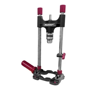

    James,
    I've used one of these to keep the holes aligned with good success.
    1. Kyle Bentley||#7
      Lining a stack up on a drill press wouldn’t be a bad idea, but they’re one of those tools that are super handy to have, once or twice a year it seems. Nobody has the tall ones. I wish they were cheaper.
