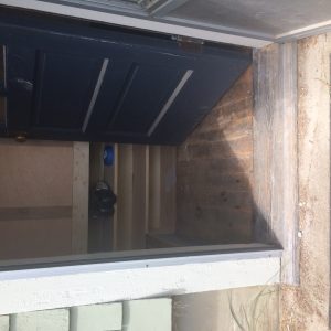

We’ve been having some issues with water leaking into our basement under our front door. We have a metal threshold over a concrete sill, and our front porch is a concrete slab about 4’x6′. There are a number of weatherproofing issues we need to address, but the most urgent is the concrete sill under the door which has been crumbling for a while and presumably is the source of our leak. I’ve removed the threshold and cleared out most of the loose concrete so I could see what was underneath. Here are a few photos:

Now that I can get a good look, my best guess is water was entering the house along the black tar paper, and not a crack as I had first thought.
Given the porch is level and roughly flush with the subsill (the darker concrete in the photo), I’m not quite sure how to properly fix this. I can pour a new concrete sill, but water is just going to sit along the seam and eventually (I assume) break down the concrete in a few years. What’s the right way to fix this?

As you probably realize, the builder of this home made two big mistakes:
1. The builder forgot to install any sill pan flashing under this entry door.
2. The builder forgot that a concrete stoop needs to be lower than your door threshold to make drainage possible.
This is a tough one. Do any GBA readers have any suggestions? I know that one solution is to demolish your front porch, and rebuild everything correctly. That would work, but it's expensive.
If you can do some more diagnostic work and figure out how water reached this area, you might be able to correct the flashing problem than allowed water to enter your wall assembly in the first place.

My biggest concern at this point is the seam between the existing concrete surface and a new poured concrete sill. Would installing some L-shaped metal flashing along the front of the sill be worthwhile? It seems like there must be a way to adhere it to the concrete porch that would be waterproof.

Existing concrete being the porch slab and subsill (the roughly level surface you can see in the photos). New concrete would be a replacement sill, so yes, a narrow band directly under the door.
