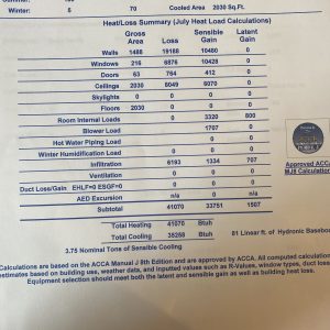

He gave me a printout of a manual J. He didn't actually go around measuring windows and doors. Just took the sq footage of the house. I've attached a screenshot of the document.
Is this the right way to do a manual J or more of an estimate?
>"He didn't actually go around measuring windows and doors. Just took the sq footage of the house. I've attached a screenshot of the document.
Is this the right way to do a manual J or more of an estimate?"
If he didn't measure anything, the Manual-J is crap. He just entered some numbers until the tool spit out something he found "reasonable".
运行燃料使用负载计算并将其与41K热负荷估计进行比较。即使是+ 5F,这可能是99.6百分位的温度箱,而不是第99位,这已经是尺度的拇指。即使使用99%的垃圾箱通常具有较好的侵略性手册-J的余量。BridgePort Sikorsky Airport的第99百分位的融合箱为+ 15f,而不是+ 5f。
