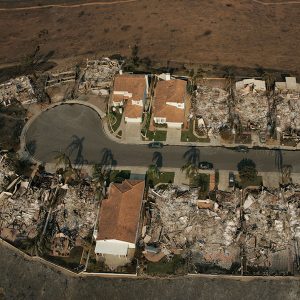

Looking at data from wildfires and looking at what happened to ICF homes AFTER a wildfire hit that area, is the best way to answer your question.

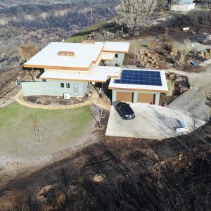

The Camp Fire in 2018 in Paradise, CA was devastating. One home that survived direct nearby flames was an ICF home. Many other recent fires have factual evidence that ICF/concrete homes not only survived fires but had little to no damage and were deemed inhabitable without having to do any work on them. Most ICF homes are finished off in synthetic stucco and not "siding" as noted.

To my understanding the ICF houses shown and the ones I read about that survived wildfires, were structurally sound and intact.

As mentioned, even if the EPS foam melts on the outside of ICF homes, which happened in one wildfire that was studied. They simply installed new foam utilizing concrete screws and washers. They then added the stucco coat and all was back to normal. The concrete wall remains structurally sound which means the roof doesn't collapse and destroy the entire home. The house is able to be inhabited.

So it's important to keep the outside "fuels" around the home, cleared and far away. That means no trees/vegetation within 30-40 feet of the structure. When you watch video or pics of the recent fires. The homes had trees sitting within just a few feet of the home. With such a fuel source nearby, the house doesn't stand a chance.
