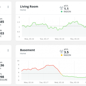

I use the view plus mounted next to my thermostat (tapped into the 24 VAC thermostat line, converted to 5 VDC). It's on the main level (ranch). I also have the wave plus mounted in the basement, it phones home via the view plus (which can relay since it has power). I could add more sensors but I think this is good for now.
I've attached a pic showing both sensors in the dashboard, lets see if you can tell when I finished sealing the basement for radon (all those cracks and corners).
