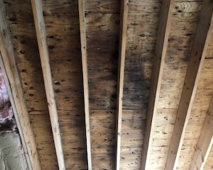

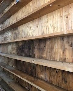

      Pete and Bill, thank you. You guys have convinced me not to simply go the "like for like" approach and fill the cavities with new R30 and move on. So, the approach I think I will take is as follows: 1) Find a roofer who can install roof/sidewall venting - Any recommendation on what brand or model wall/roof vent to use? 2) Install plastic baffles 3) install new faced insulation 4) make sure all top plates, gaps, penetrations, etc are foamed or caulked 5) Use a foam drywall gasket prior to installing new drywall. 6) Ensure rafter cavity has holes in the soffit to allow intake of air. Does think make sense? Also, here are a couple of photos of stained sheathing, not sure if caused by no ventilation or previous roof leaks. No noticeable leaks or damp areas currently. Thanks again.
      1. Expert Member
        Zephyr7||#4
        That’s mold. That means you’ve had moisture problems in that roof assembly, which is not surprising given the way it was originally built. That mold doesn’t look too bad though. I would clean it with a mold killing cleaner (which can be as similar as vinegar, or use a commercial product). I would then paint over it with a mold killing primer to keep it from coming back. Once you’ve done that, insulate and air seal as we’ve described here and you should be in good shape going forward.
