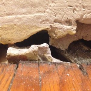

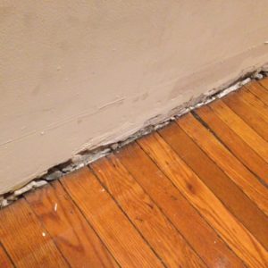

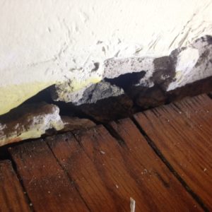

我想处理空气渗透和leaks and I've included some photos of what I think is pretty typical behind the baseboards - how do i deal with this? Particularly on the external walls?
As I mentioned previously gaining full access to all of the rim joists in the basement is basically impossible.

First, with a hole saw /other,n carefully remove some of the plaster to get a better peek at the wall stackup. If you open up a 2" hole and peek in with an eyeball or boroscope and all you see is brick an inch or two away it means the lath is supported by lath, and there are no studwalls. You may be able to figure some of it out probing in there with a stiff wire (like a cut wire clothes hanger) or thin screwdriver.
In the basement where you DO have access to the joists, take a look and see how the floor joists & rim joists (if any) are being supported at the exterior wall.

Use canned spray foam. Then replace the baseboard.
The baseboard can be caulked in place if you want -- with a bead of caulk between the baseboard and the flooring, and another bead of caulk between the baseboard and the plaster wall.

I'll check again tonight but when I used a flashlight to look into the bigger hole in the photos I'm almost sure I could see red brick as you say a couple of inches away.
Martin - thanks. I didn't think I could add caulk between the baseboard and the actually flooring due to the floor expanding and contracting - is it best to use 100% silicone caulk for this? something more flexible?

I have seen weatherization contractors use clear silicone caulk in this location. Silicone caulk is flexible enough that you don't have to worry about the caulk limiting movement in your floorboards.
