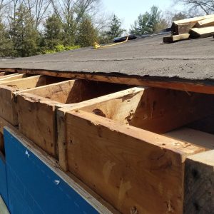

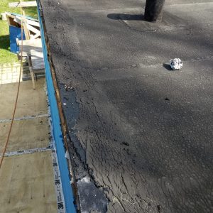

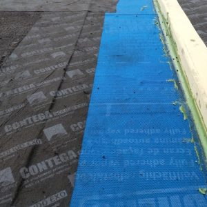

      Thanks Jamie! I've attached few photos of the situation to this comment.
