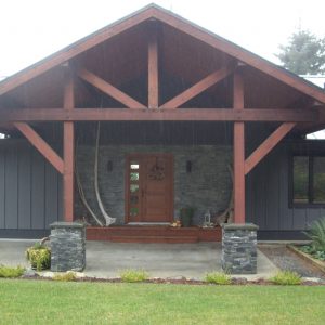

Bob,
As a substitute for the framing package you get from a lumberyard I agree. However, I've got three small sawmills within ten miles of my place that will custom cut any species to any size from trim to heavy timbers. Their mills are all computerized and cut to very exacting dimensions. The surfaces of the lumber is well enough planed that I often don't need to sand before applying finish.
