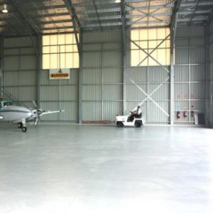

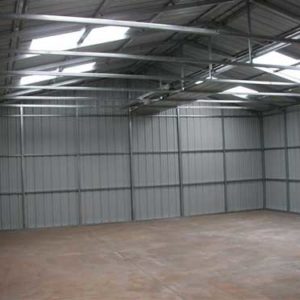

    还有一个问题:你能描述金属建筑内部的样子 - 将用泡沫绝缘喷涂的表面吗?我假设内部具有暴露的钢柱(柱),暴露的钢梁和齿槽,并且(在这些柱子和梁的外侧)某种类型的钢包层。它是否正确?
    换句话说,它看起来像下面照片中的建筑物吗?

    3. Yes, the inside of our building looks a lot like your photos. Red metal. The columns are larger and just two girts that look further apart than those pictured. No trusses like those pictured though, it's all open. I don't have any pictures of ours inside but will see if I can find one online like ours is made.
