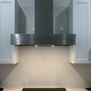

I am using a modern looking 36" Vent-A-Hood recirc over a 30" induction stove. I also have a Zehnder Q600 and the kitchen exhaust is about 10' from the hood. It does a good job removing smoke and odors.
I like that style but all the studies show having a larger volume than those flat ones helps a lot with capture efficiency. But Vent-A-Hood is good so they probably have a good capture efficiency. It also helps that you have those cabinets next to it. Studies show that helps quite a bit. But I wonder what your particulates and cooking chemicals would actually measure with re-circ. I know a lot of PH people are doing it but based on the new research I doubt it's really as effective as we'd want.
我认为一个好的部分公司的令人不快的事情me from cooking are eliminated just by switching from gas to electric. If I had a gas stove and was frying steaks in a pan every night then I would go with an externally vented hood. For what I am doing, the recirc is fine. I have multiple IAQ monitors in the house and I don't see a noticeable jump in VOC's when cooking. Granted I am not measuring particulates, but at nearly 400 cfm between the recirc and the Zehnder, I am comfortable that most of the bad stuff is being dealt with. There are a couple of things I would do different in hindsight. First, I would have made the counter depth 27" instead of 24". This would have allowed me to use 15" wall cabinets which would have helped even more with capture (and provide a little more counter space too). Had I done that, I would've also lowered the hood height a few inches. The manufacturer recommends a hood height of 24" which just seemed way t0o low for comfortable cooking, but it is better for capture. By moving the countertop front edge out but keeping the cooktop the same distance from the back wall, the cooking angle would have changed enough to allow me to lower the hood a bit.
I also should note that even when not using the hood, the Zehnder does a really good job of removing at a minimum cooking smells when running at anything above vacation mode. The other night we cooked a chicken in the steam oven. We had 3 days of 100% outdoor humidity thanks the Hurricane Henri. First floor RH was 50% and 2nd floor peaked at 59% before turning on the dehumidifier and setting the Zehnder (ERV) to vacation mode, which brought the levels down below 50%. Typically, I never smell the remnants of what we cook, but even the next day I could still smell the chicken on the 2nd floor.
