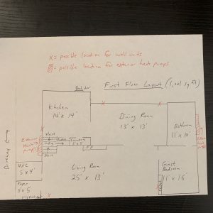

      根据我在春天的最后一次鼓风机门测试,我现在整个房子的供暖负荷大约是38000 btu。但从那以后,我换了8扇一楼的窗户和5扇地下室的窗户。我还打算在防火箱上安装玻璃门,最重要的是,我即将进行一个整个房子的空气密封项目。我对空气密封工程结束后我整个房子的热负荷的最佳估计是大约31500磅-这是假设从春季的20磅/立方米减少到10磅/立方米。有趣的是,我只需要两个豪华的12000单位就可以达到31500单位的热负荷。我也可以用三个豪华的六千单位。所以我想现在最好的选择是楼下两套12000的豪华公寓(1000平方英尺)楼上一套都没有(500平方英尺),或者楼下两套6000的豪华公寓楼上一套。两个12000的单位可能会更便宜;三个6k的单位在空气流动方面可能更舒适。我的楼梯非常开放,有两个入口(一个从客厅,一个从厨房)——两个入口都没有门。 You and @Akos both gave me a lot of good advice last spring, and I know you were advising a ducted solution, but I just don’t think that’s going to work on either the first or second level, for different reasons. The problem with the first level is that I’d have to make a bigger hole in the foundation between the basement and crawl space in order to get some of the ducts to some of the first floor rooms; plus, ducts leak, and we have some historical and some recurring asbestos/mold/radon issues that I am dealing with, but I don’t want to risk blowing our nasty basement and crawl space air onto the first floor; also, the prices quoted for ducting just the first floor are around $20K while two to three wall units are $10-15K. The problem with the second floor is that our attic is also currently unfinished/unconditioned

    你能提醒我你在这个国家的什么地方吗?我想在11华氏度的设计温度下一楼需要空调吧?
    还有,在你画的原始平面图上,你能告诉我卧室的储物柜在哪里吗?
    1. Kieran973||# 7
      你让我想起那张照片有多糟糕,所以我试着在这里重画。客房的衣帽间在与客厅共用的墙上。
      我在CT南部,靠近纽约,刚好是5气候区。一楼需要空调,我们有几套有窗户的公寓,这没问题。谢谢。

    我同意你关于中间选择和一对一迷你拆分的重要性。在设计温度下,楼下一个12k,楼上一个9k,总共大约是29000,如果我在楼下安装两个12k,那就是32000,但是楼上没有直接的迷你分热(只有水循环散热器)。如果我用三个6k单位(两个向下,一个向上)它将是35000 btuh,三个9k单位将是38600 btuh。
