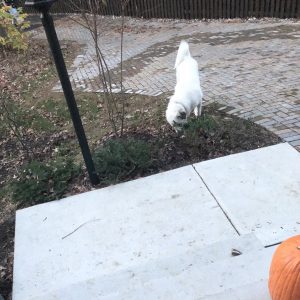

I had a mason recently install Cement pavers over an existing concrete patio around my pool area, some of the area was grass and they laid gravel and sand to level it out so it would be even with the concrete (This area you can see no moisture is seeping through the pavers).
There is a ton of moisture seeping through where the joint sand is and my mason is adamant that the sand was incorrect.I gave him the benefit of the doubt and let him put new polymeric sand in.The moisture is still appearing but now it seems more evident than ever. This is now three weeks into the finished job and it just will not disappear. I have sen someone else posted this topic but wanted to see if anyone could please advise me on the issue.
I am in the east coast Connecticut and the weather the since the job was done has been at an average of mid 50’s.
Please see attachment.
I thank you for your time and any advice would be greatly appreciated.

  3. Ilevel.||#3
    附加是混凝土的两个图像,草地区是原始红色摊铺机的原始红色摊铺机被贬低。

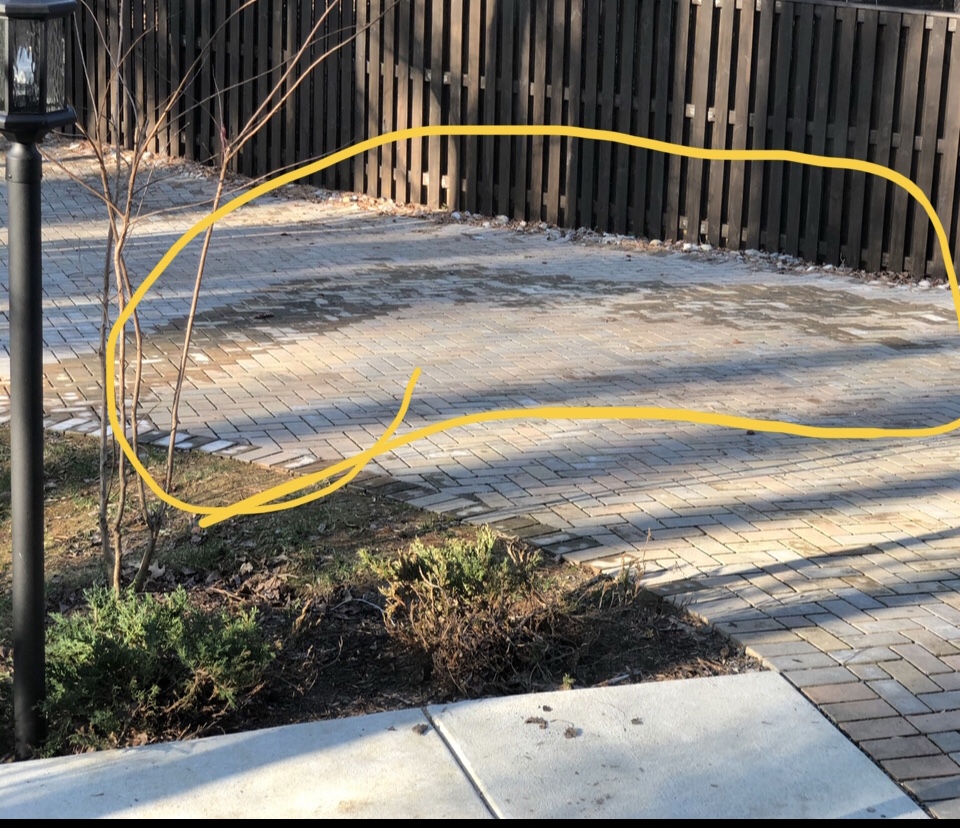

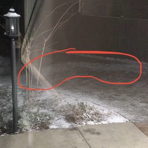

    I have a SIMILAR ISSUE: theres a “V-shaped” Wetness.
    在这里,我有3张照片,始终显示冬季摊铺机下的V形湿度,秋季甚至现在,春天2021。
    BIGGEST Problem is- my House is barely 8months old.
    曲线球是摊铺机远离水/大型池塘的20英尺,导致河流 -
    然后到切萨皮克。
    Contractor said-
    “这是正常的,因为我家的高水位。”
    IS THAT TRUE?
    Is the wetness under the pavers NORMAL???????
