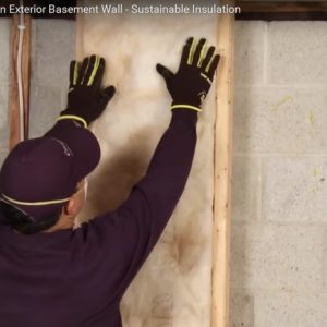

    Here is CertainTeed's solution (replace poly with MemBrain).
    https://www.youtube.com/watch?v=AE7vWSZHI3I
  5. GBA Editor
    马丁·霍拉迪(Martin Holladay)||#5
    乔恩·R,
    It should come as no surprise that CertainTeed (a major manufacturer of fiberglass insulation) is eager to sell fiberglass insulation.
    但是他们的视频是错误的。此方法不是“最佳实践建议”。混凝土地下壁可以从任一方向弄湿 - 与潮湿的土壤接触或潮湿的室内空气的凝结。安装膜不会在这种类型的墙中阻止霉菌。视频中的图像使我发抖。
