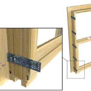

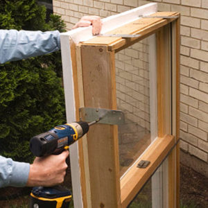

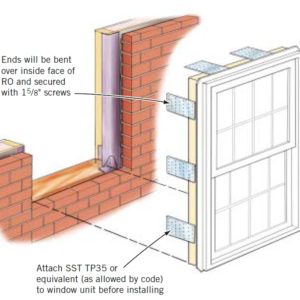

You need to follow all of the usual rules for installing windows, especially flashing rules. The entire window rough opening needs to be flashed. The sill pan (either a site-built sill pan or a manufactured sill pan) is especially important.
I'll attach some photos of masonry clips below.
