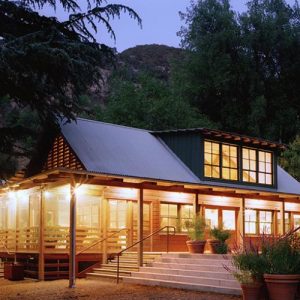

    马尔科姆·泰勒(Malcolm Taylor)||#2
    Mike,
    在两个桁架湾上建造一个长的冲天炉或棚屋。

    马尔科姆(Malcolm),构架冲天炉或窗户可能是一种选择,我只是想知道我的天花板和大细节细节。我会考虑一下。

    For consistent lighting, north facing windows are best. That also avoids the heat load of sunlight entering the space. A clerestory window like those Malcolm shows above is by far the best way to light a workspace with natural light. It will require some detailing, but it is probably worth the effort. Otherwise, the sun tunnels are a great solution as well.
