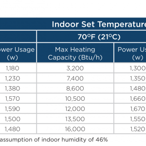

It's a marketing ploy, don't be fooled. If you look at the submittal sheets the BTU outputs at -15, -22 and -31 are pretty terrible. Here is the heating table for their 12k btu unit.
The GE compares poorly against the same sized Fujitsu at every temperature, both in term of max output and efficiency. The Fujitsu tops out at 22500BTU/h at 47F, and is nominally rated the same as GE's max output, 16000BTU/h. At that output, the GE consumes 50% more power, 1520W vs 1010W for the Fujitsu.
Look at GE's numbers at -31F. 3200BTU/h at 1300W. 3200BTU/h=940W, which is a COP of 0.72, 30% LESS efficient than straight electric heat. That's a joke.
